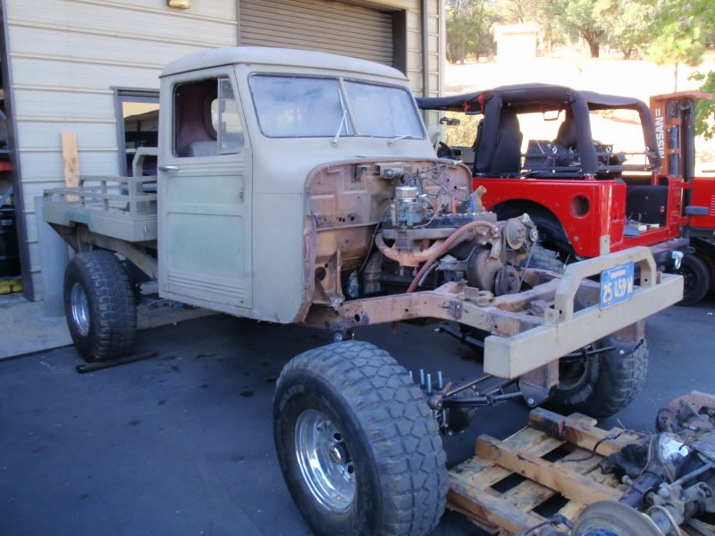

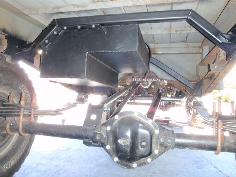

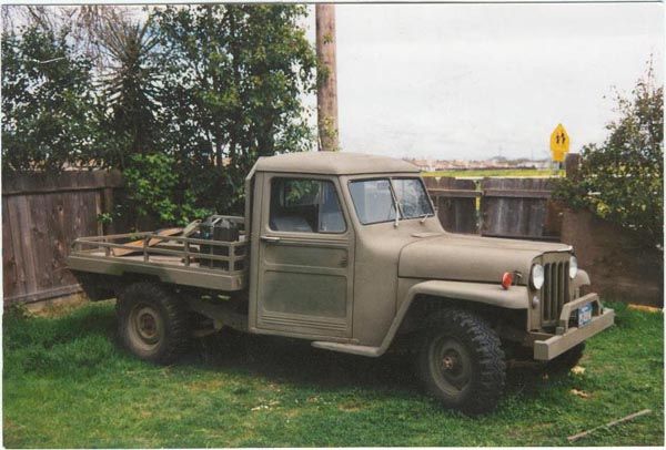

This is what it looked like when I bought it about 10 Years ago. Completely stock, the motor ran great, everything else was junk. $2,700

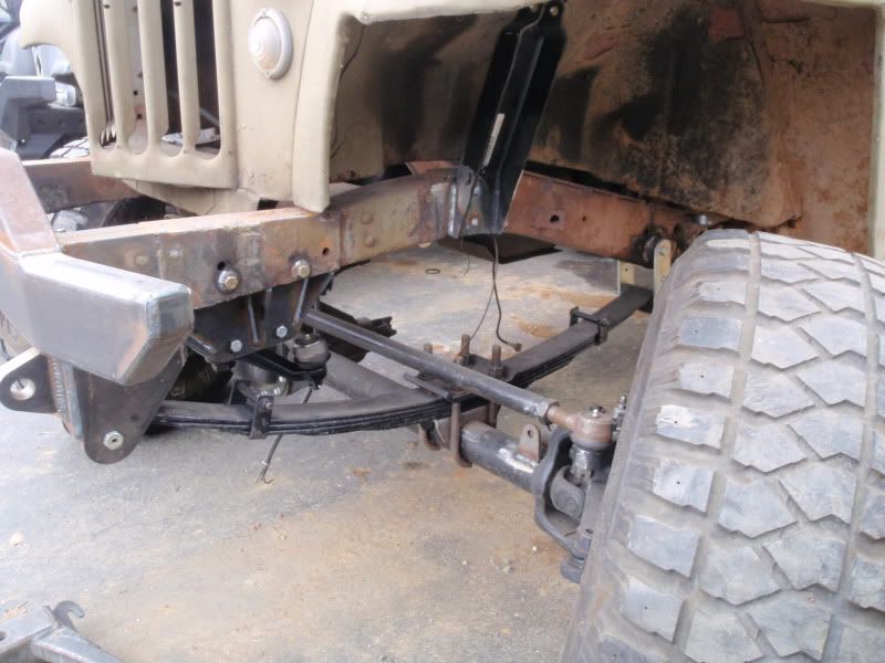

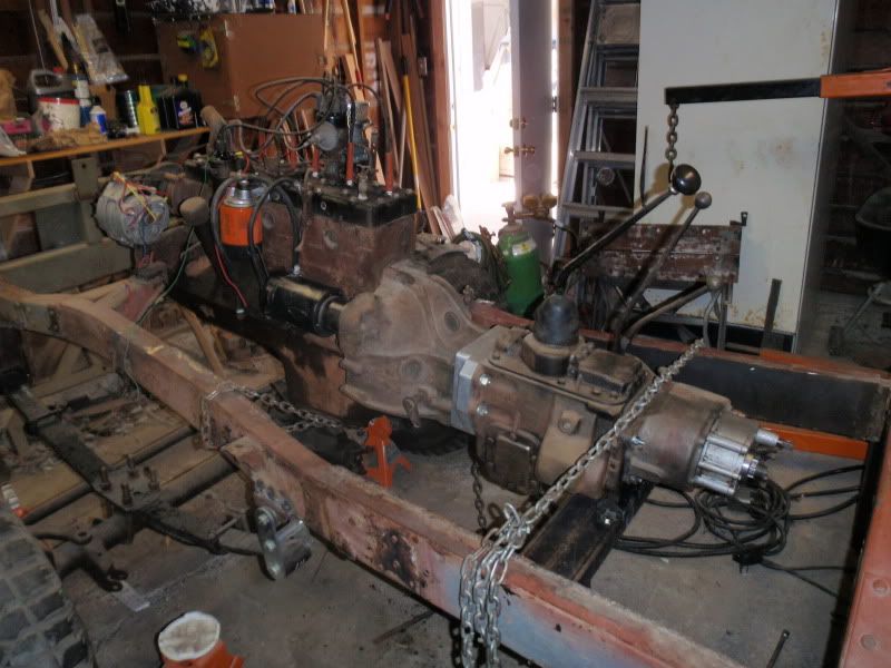

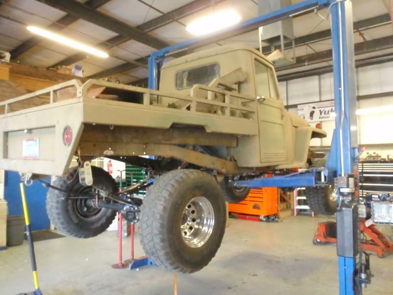

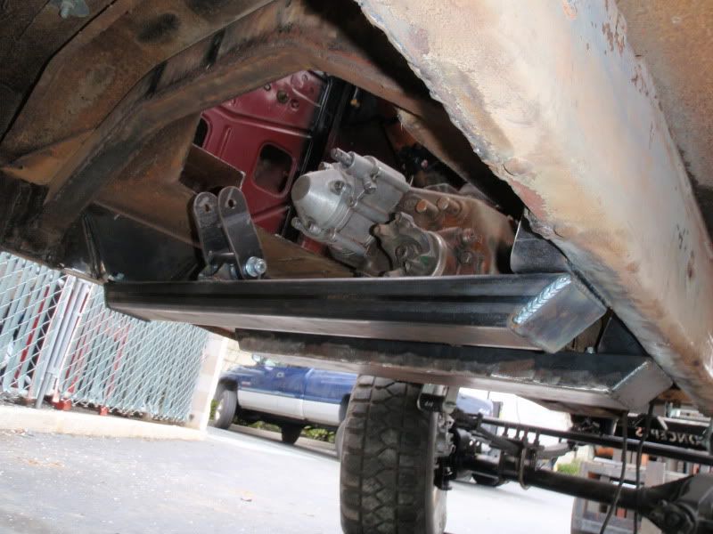

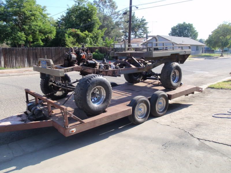

What did your axles originally come out of. I've been wanting to upgrade the stock axles in my 47 pickup to something newer. What mods did you do to the steering linkage? Thanks!Here it is a little over a year ago... Boxed Frame, T-18 Transimission with a custom adapter plate designed by me. Wide trac Dana 44 axles with 5:38 gears, powrlock posi in the rear. Super 18 Transfercase (Dana 20 case with Dana 18 gears, and 1.25" intermediate shaft.) Stock Super Hurricane Motor L6-226, and a Warn Overdrive.
