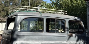

I scrubbed the windows, then I reworked an old roof rack I fab’d up for a CJ5. It’s stretched to fit the wagon better.
I’ll snag some 1” tubing to attach it to the roof properly. Then run some oak slats front to back for more stability.

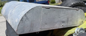

I found an old vintage Cargo Holder locally online. No key, but it will get disassembled and cleaned up, maybe repainted. Definitely insulated.
View attachment 185883View attachment 185884
