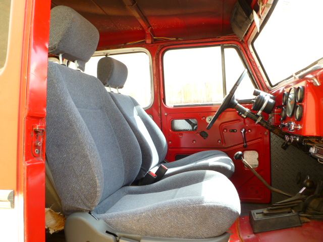

I got this front seat from a '97 Tacoma that was going to be crushed because of a rotted frame;
it's dimensions are almost identical to the Willys seat, the pass.side is actually an independent seat and it automatically slides forward when the seatback is tilted forward, for easy entry/exit to the rear seats.
