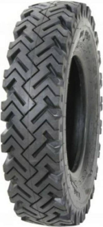

Here are 3 of my possible candidates:
This one is a Rosava VLI5 in 175/80R16 (6.95/16) - this is basicaly a stock Lada Niva/Cossack tire, made for decades since the Soviet era without
any significant changes. It is a tube type and runs for €99 including tube.
This one is a turkish made GTK KM420 in 6.5/16.Also tube type. Price range about the same as before
and the last one is SC ML814 in 7.5/16 Looks similar to Deestones but the price is around 130-140
What would you suggest?
