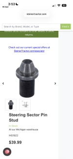

How do you remove the pin? It looks as though it's machine pressed into place. Next question is how do you install the new pin? Also, I didn't noticed that those pins are for sale.
I have them for my Ross box but haven’t sorted the removal out. I believe they are pressed in and then maybe a spot weld but not sure
Steiner tractor sells them. I measured mine and found the same ones. Been about 3 yrs ago but will look for what I ordered

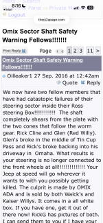

Just avoid omix stuff unless they have improved them I would ask what the supplier is. No idea if other than Omix out there. NOS is very hard to find.

I bought a new sector shaft several years ago for the CJ5 and it did not match up well to the worm. For sure look for a NOS.....it might take a little time, but worth it.

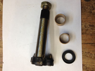

This is my old sector shaft. It looks good to me, I'm not sure why I did not re-use it. I think I replaced it before I rebuilt the front end, hoping for a quick repair...I ought to put it back in, just for fun....
