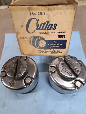

I found this on Ebay and sent the seller a question on the sticker contained in this kit, will see if they reply.
These say Ford in the Ad. But I figure the sticker is close enough.
