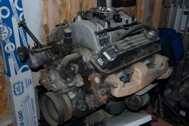

I did forget to mention, if the engine is trash, I do have an about 320hp newly rebuilt complete Mopar 318 magnum sitting on a stand in my friend's garage right now with complete harness, plus auto trans, and a clocking ring to put the D300 on that tranny. It will be going into my Grand, but it doesnt HAVE to :D
So I have options.

Ive been doing a lot of research today on what to do to my new wagon. And Ive been thinking A LOT about the 318 magnum engine Ive got. It is nearly ready to go into my Grand, but if I dont, I need to rework a few things on it. Ive run across a really useful page that isnt helping the decision to be responsible and put the engine in my DD. Novak Adapters has a good page on engine swaps on old jeeps. Nothing that a bit of common sense doesnt cover, but its a good resource.
http://www.novak-adapt.com/knowledge/ut ... _swaps.htm
But one nice thing is they have motor mounts for this engine into this truck, which would make my life much easier. So I am STRONGLY considering ordering a set and installing my freshly rebuilt 5.2L Magnum engine, 44RE, and D300 combo in this rig. I could even install AC if I wanted, but its not a necessity here really. I might go to that trouble later. Its also already set up for power steering, and its not the same swap everyone else does.
http://www.novak-adapt.com/catalog/engi ... mx-nd1.htm
If I were to go this route, the Willys should become the DD and Ill likely turn the Grand into a trail rig since I dont want to sell it. Its been my faithful DD for 7 years, Im ready for something new.
Has anyone else swapped in a Magnum or a Dodge engine to their Wagons? Ive seen a few CJs, but no Willys trucks.
