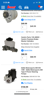

Have any of you done a full disc conversion but used the stock master cylinder? The $400 for a dual master from Keizer Willys is a tough pill to swallow.

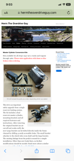

You might check out Herm the overdrive guy for a duel master cylinder. For my CJ-2A I paid $310 including shipping. I think it is the same one KW sells at a mark up. IMG_9350.png
tha
You might check out Herm the overdrive guy for a duel master cylinder. For my CJ-2A I paid $310 including shipping. I think it is the same one KW sells at a mark up. View attachment 155818
thanks for the info.
I am going to be using Herms bracket. The reservoir I went with a 3/4” bore on recommendation from Brennan Metcalf from Brennan Garage(he makes brackets for mounting your calipers).

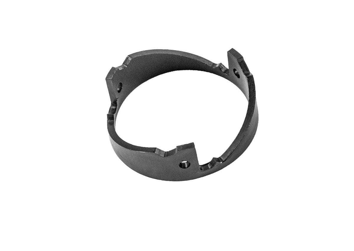

I found out the lock out cam for my selectro hubs was broken on the drivers side.
I did find a Derlin replacement part.
