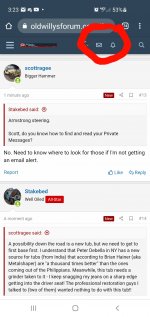

Armstrong steering.
Scott, do you know how to find and read your Private Messages?
