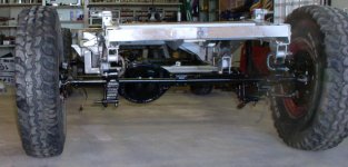

I installed the axles onto the frame for a rolling chasis.
Next, I added the 21 gal. fuel tank. It is also painted with Rustbullet. I have the original tank, but it is just too small.
