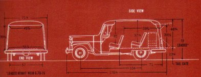

Don't know if these diagrams might be of some help...
Doesn't show the mounts in particular. I just purchased a 49 2WD Station Wagon, and just finished(???) my 59 resto-mod, so can get some specific measurements if needed, but so far, agree with Tim & Phil, the tranny tunnel is definitely shaped different , less roomy on the 49.
