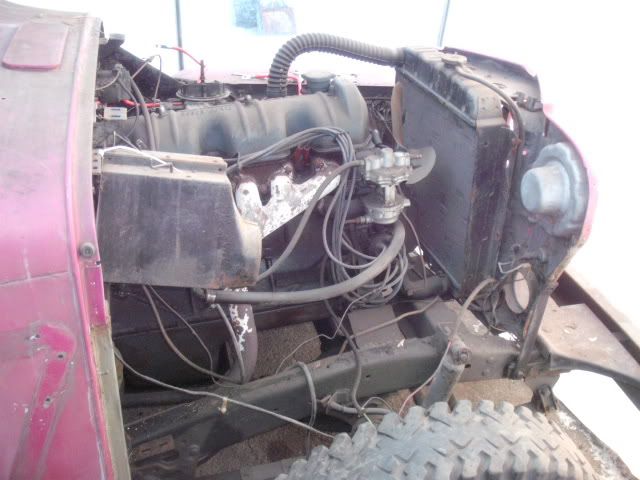

Here's my barn farm. It was in storage for the last 15 years It's in decent shape, the engine ( 230 OHC) was rebuilt a couple years ago but was only used for 100 miles.It only need a few gasket and a carb job. The body is in decent shape.. small hole in the driver floor pan section and driver cab corner.
The bed floor is perferct so is the tailgate and head board. The side panel will need a bit of cutting and welding. It's an 99% original truck ( bumper and paint is not). I intend to do full frame off rebuilt and leaving it as original as I can.
here it is when a brought it home

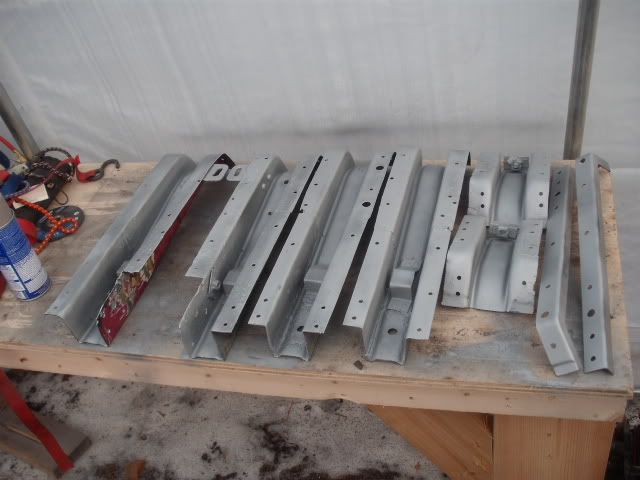

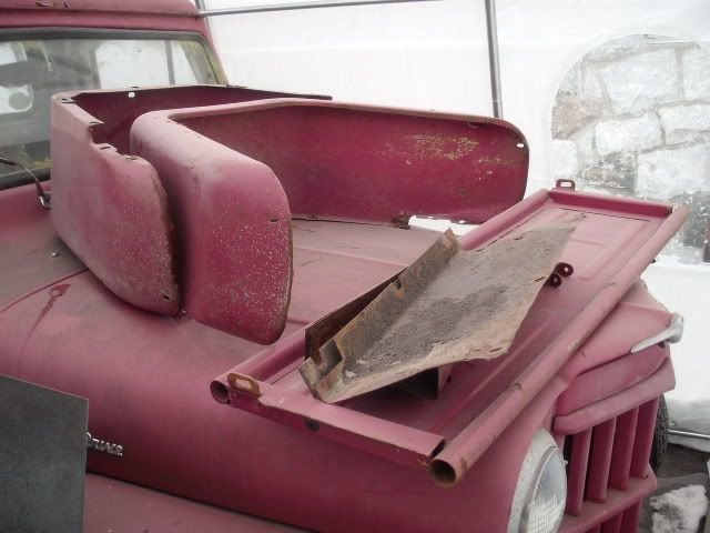

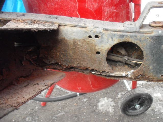

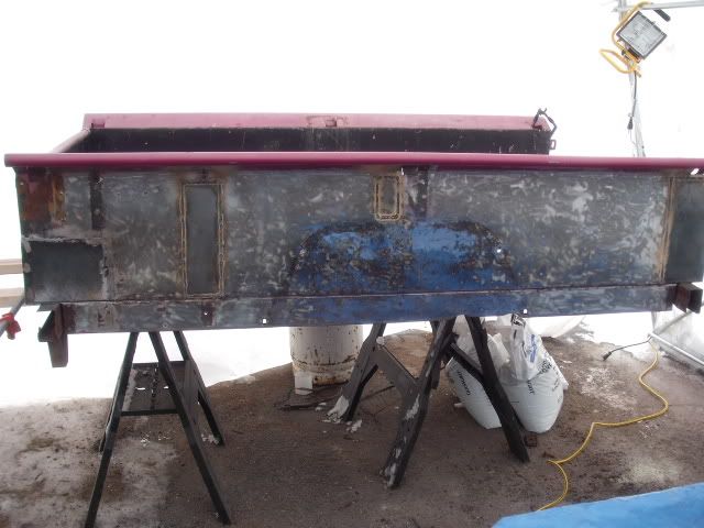

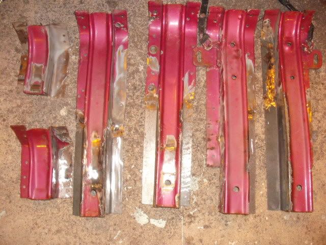

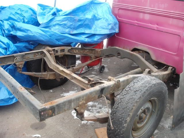

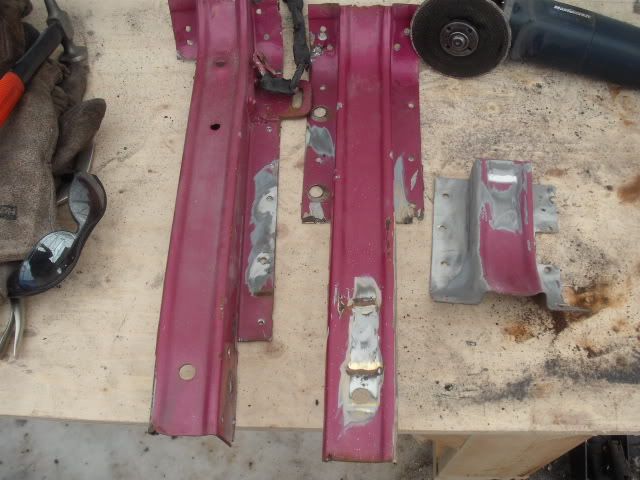

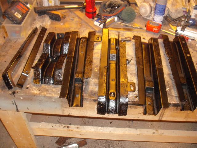

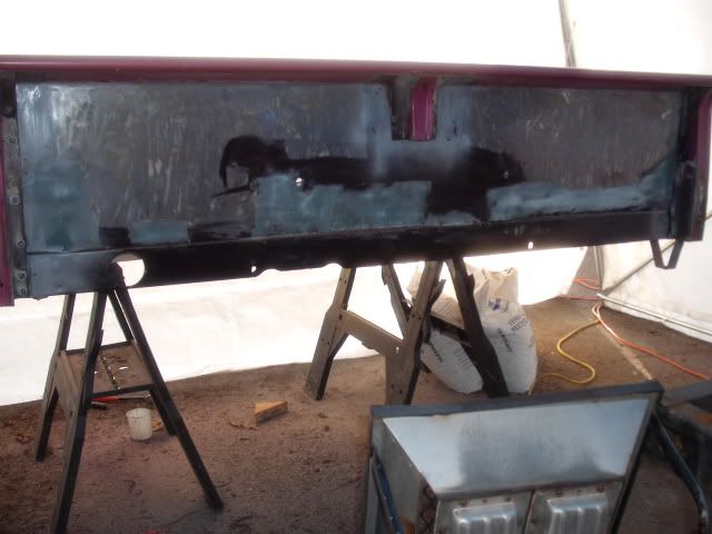

Well I spent the last 3 days woring on the truck :thumbup: , It took the bed of the frame and the gas tank to see the frame. Well suprise it's in really good shape, only one minor repair to be done near the midle crossmember. Now it was time to check what's under the paint... oops crapy body work, tones of bondo with ugly welded patch over rusted panel. It was time to cut everything out and weld new 16 gauges panel. The side pocket were in bad shape so I had to cut and weld those too after removing them from the bed ( darn spot weld :lol: ). Everything went well with the cutting and welding. It's almost ready, it still need some grinding, and welding the side pocket to the bed. I will paint the underside of the pockets with Por-15 and some Zinc weld tru primer on the bed section to help with futur rust.
here are a few pics

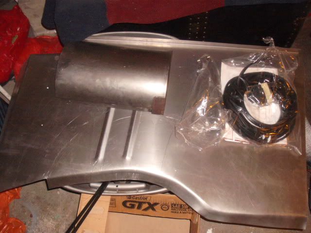

Christmas gift from Walck's
Looking good. Surprising there is that much rust on one part of the frame and the rest is OK. Hope you have someplace inside to work on it Canada can get chilly this time of year.
my guess for the rusty part of the frame is, there's a leaking fuel line that dripping in the corner. With the sand inside, it's a trap for moisture.
It's my 4th frame of over the past few years and all of them were done in God's garage.. I'm working in the Tempo with a 60 000 BTU heater this year. I feel lucky as the other years I had nothing :roll: . The small parts I can do them inside in the workshop, but most of it will be done outside.

did not do much in last few days... Por-15 on the back of the pocket with weld tru primer over the patch. Welded the pockets back on. And did a test with the body filler over por-15... this is it !
I might do a bit more next weekend :cheers:

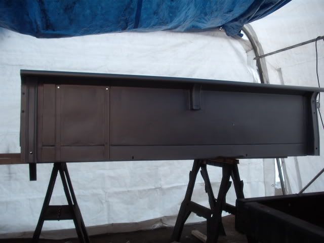

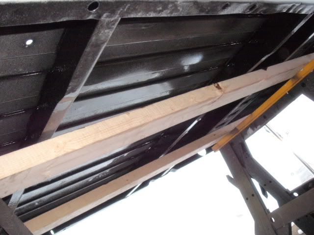

More was done in past few days on the Bed, finished sanding and grinding, all the welding was done. degreased and painted the underside with gloss black tractor paint. All side panel received 2 coats of rust bullet. I will leave it that wait until the reste of the body work is done, so I can paint all parts togeter. These are not the best shots but my space is pretty small, to much snow to work outside :roll:

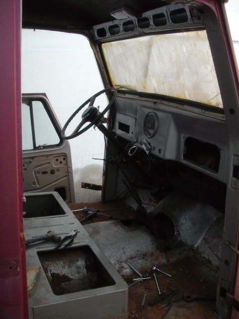

Started to work on the cab not much but, doors, seats, fenders are out started removing all dash parts.

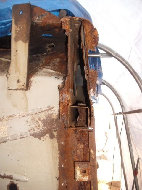

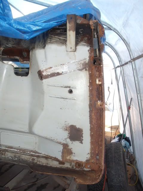

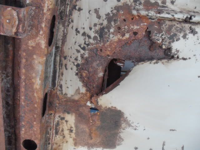

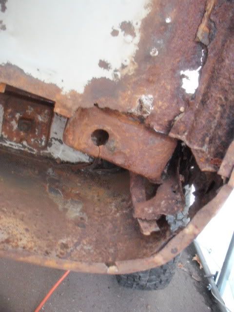

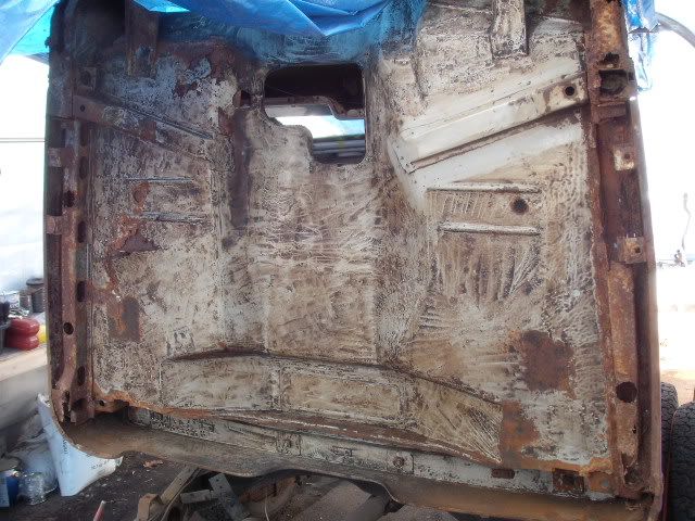

snow is starting to melt :thumbupleft: things should go faster in the next weeks. Finished removing all the dash parts and steering column. Then flip the cab over to look at it from under :shock: . Had to clean 1/2" of old crap to see something. Things are not looking so good from close up ! passenger floor is shot so are the rockers and front corner. Driver rear cab corner is rusted out. The PO welded some patch over the old rust, it only got worst, what was he thinking ?
here's the floor after removing all the crap
driver side with floor brace removed
rear cab corner
passenger side hole in the floor
