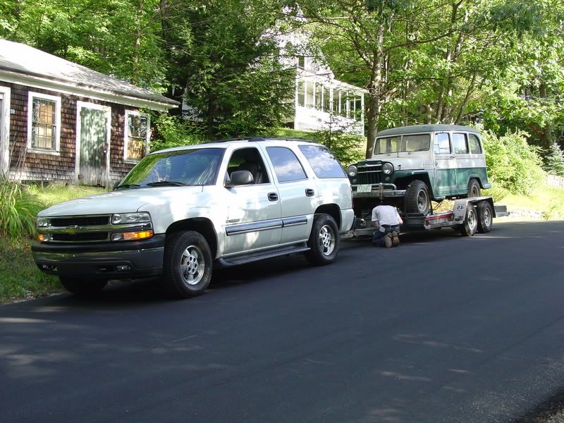

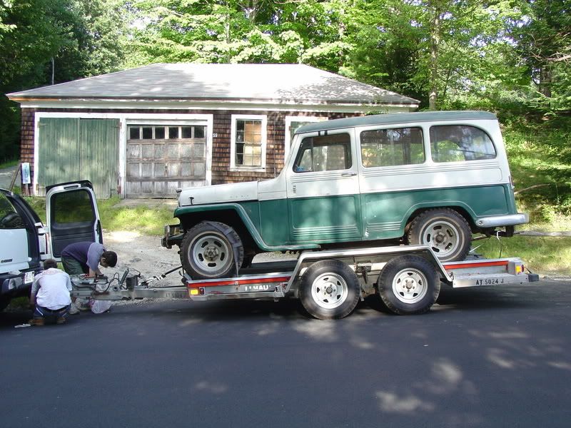

This willys has had 2 owners before me. The first was a family from Arizona who drove it to New Hampshire in the late 60's early 1970's. The second was a man who bought it in 1973. It stayed in his family untill 2007 when we bought it. As the story goes the previous owner purchased the willys when he was in highschool. He repainted it and replaced the motor with a chevy v8 (283). He then planned to drive it cross country with his best friend only making it to Vermont before turning around and taking his fathers Blazer instead. From 1977 on it pretty much sat around his farm in a barn being used occasionally. It was last tagged in 1983 and proceeded to sit. The owner passed away and the wagon continued to sit. Then needing its space it was offered forsale on creglist. I was told it was rust free and had been sittin for quite some time. It was infact the cleanest wagon I have ever seen and a deal was struck.
This is how we found it. A true barn find and the tires still held air!

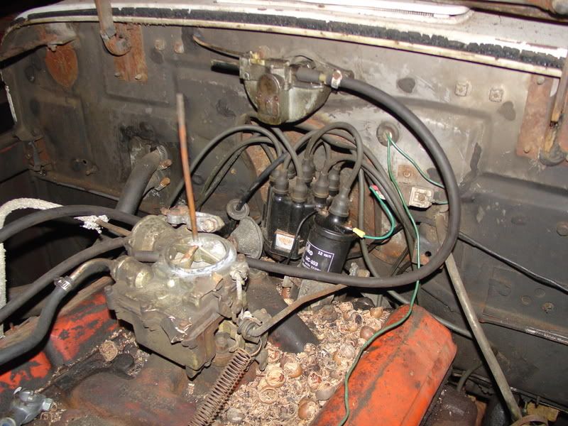

The motor was ummm nuts

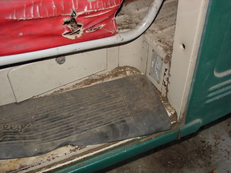

original floor mat cool

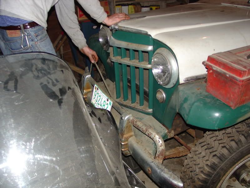

front bumper had a nice hit

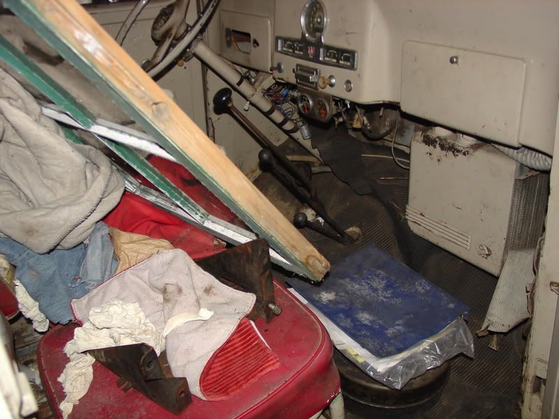

Found the orginal owners manual under the seat in a folder

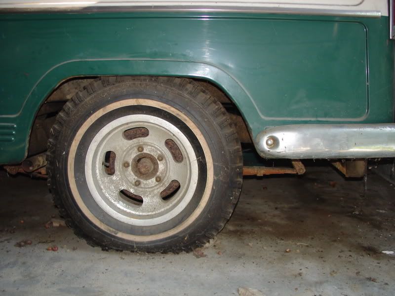

Gonna need new rear leaf springs. been sitting so long they have gone negitive arch

first time outside in a long time
Headed home.!

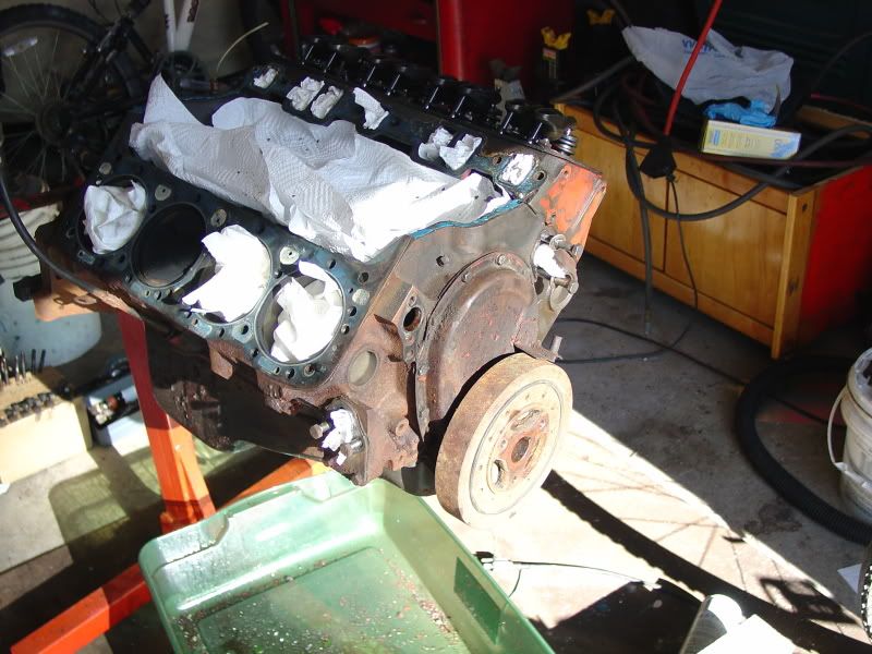

So the first order of business was to see if we could get the old chevy to turn over. The answer was NO. When i picked up the wagon the spark plugs had been out of it for an unknown amount of time. The harmonic balancer bolt was also snapped off a tell tale sign she was locked up tight!. I tried everything to free up the motor but it would just not move. I believe it was over heated and that would explain why it had sat for so many years.
washed it on the way home. has alot of dents but no rust and the paint still shines
You name it i tried it to get the pistons to move but they are locked up solid!

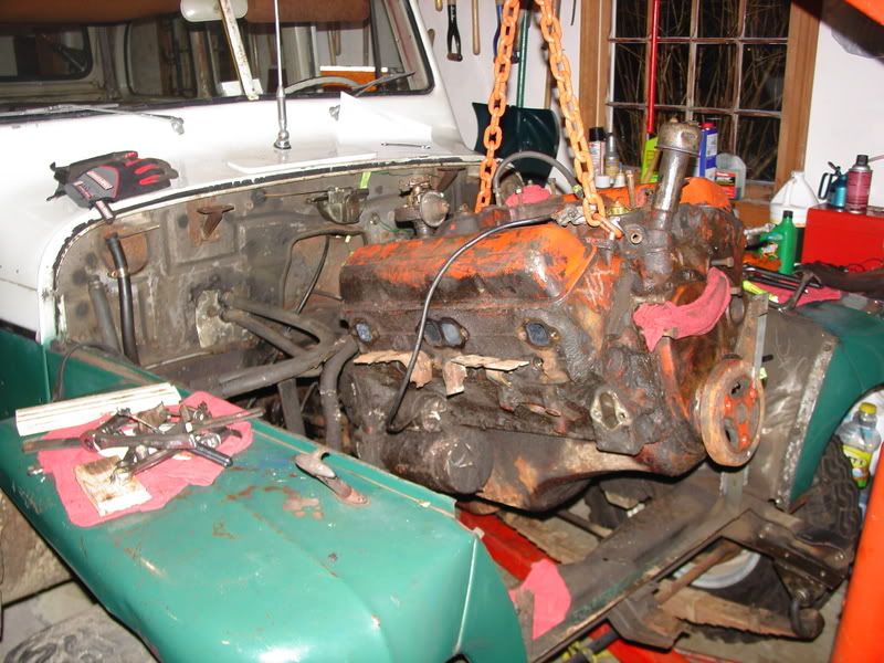

so out came the motor to be replaced with another v8

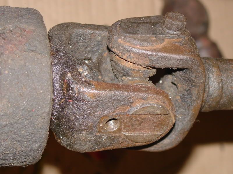

Oh joy Cleveland joints!

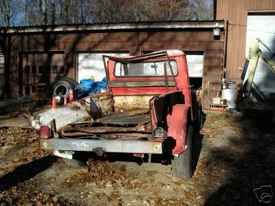

So i needed a motor. I found another willys with a 1978 350. A tree had fallen on it and ended its life. Also the frame was rotted out. I parted the truck out and put the motor in the wagon
I honestly have never been happy with this motor. It idles high due to an intake manifold vac leak and smokes a bit. To fix the manifold leak I would need to pull the distributor which i cannot do in the willys because of the firewall. Since the input shaft seal on the transmission is leaking and the motor needs to come out for that I have decided to replace the motor again.

That was quite a find. I was diggin all the acorns stashed on the intake of the 1st engine. Looks like you took a great home from some little critters.... Hopefully the went running out of all the cracks with the wash on the ride home.

Great, great find and welcome to the forum...however I can't believe you took the SBC 2 barrel that ran on acorns out. Are you going to keep the original paint on her?...good luck

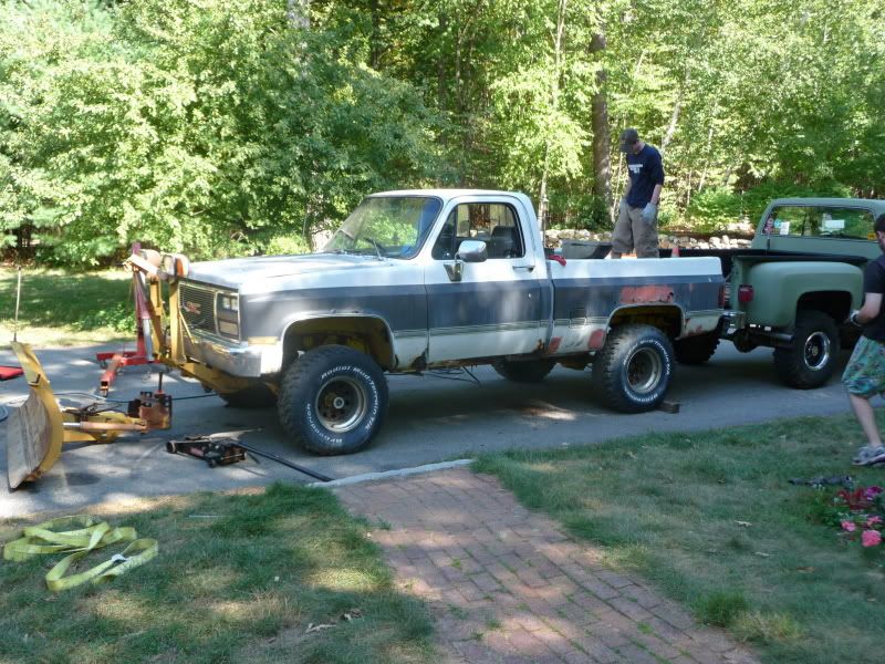

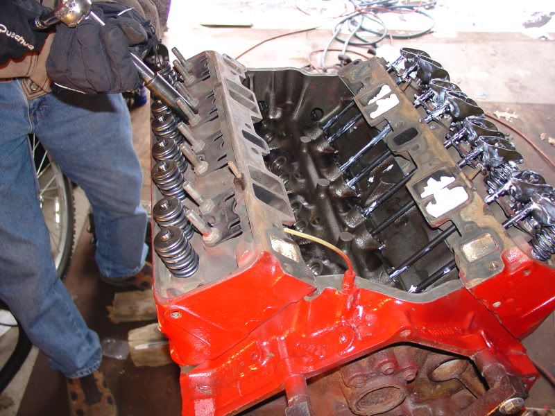

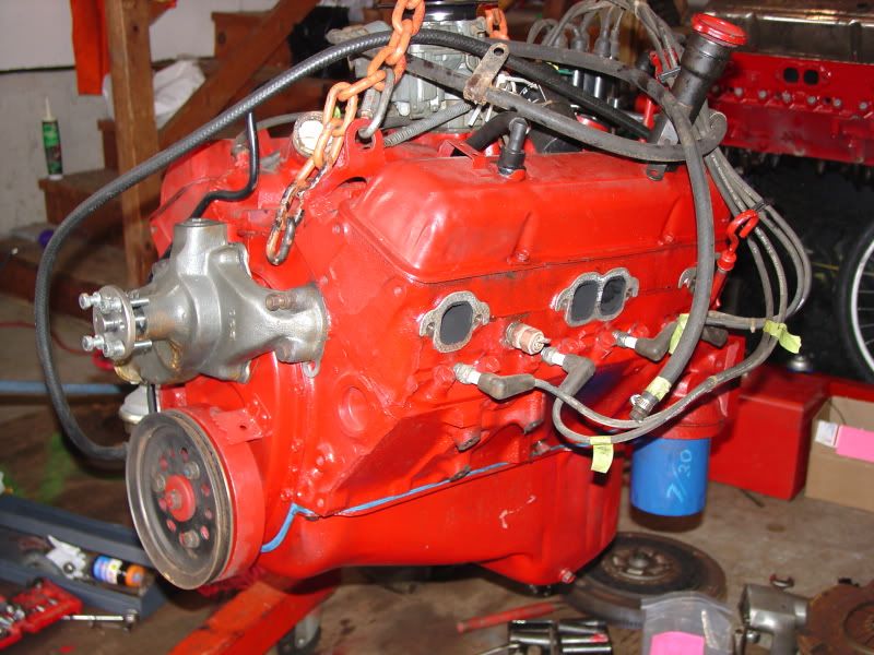

Well I have been getting parts together and the motor is almost ready to go in. I live in the North East and If any of you are firmilar with this area the climate is quite moist. We get Snow in the winter and the DOT loves to use Road salt. Well the donor motor came out of this old plow truck. And boy oh boy was it rusty!

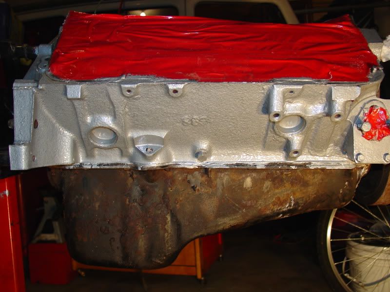

I broke almost every exhaust bolt off in the heads. This was not too bad I just wedled nuts to the broken bolts and was able to remove them. Next two of the spark plugs sheared off in the heads. That brought on the suck! I decided to pull the heads so I could inspect the cylinders and get them checked out. Well they are double hump heads off a 1969 327! Great so I got a hot little 350 going in a stock wagon. To prep the motor for paint I cleaned and chipped off as much scale rust as I could. I then used Metal Ready to prep the surface.
After that cured I applied two coats of POR-15 rust paint. Since I had cleaned the block so well the metal ready was needed to etch the block and any bare metal. The trick here was to alllow the POR to set up and get tacky and then lay on the engine enamle. IF you let the POR completely dry it will not bond with the top coat and things will peel. I used the silver because it contains aluminum which fills in the divits and viods.
I did not paint the pan because it was rusted and had a hole. Also make sure you don't get the POR on gasket surfaces as it is a PITA to get off.

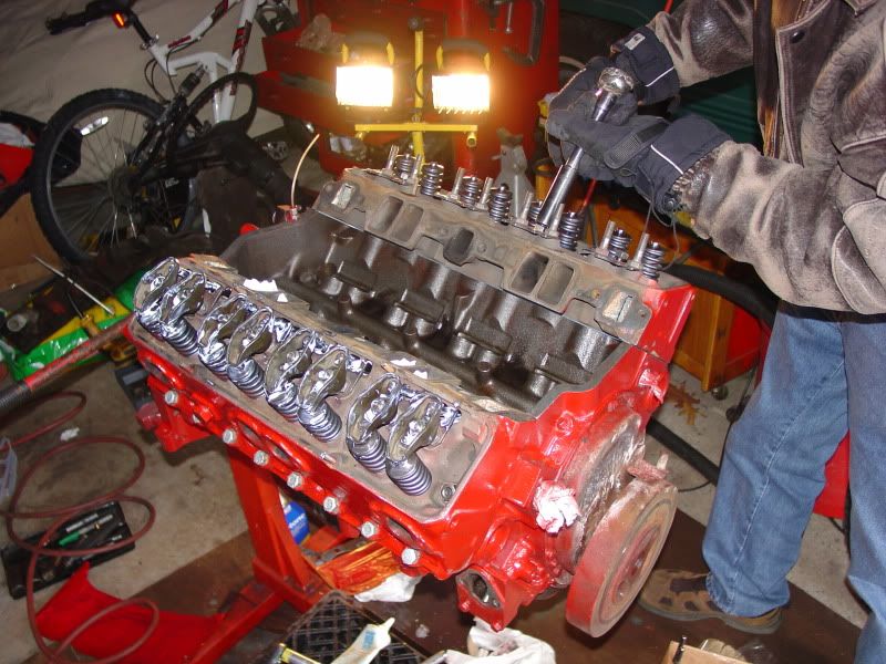

I was debating between chevy orange or red. I chose red because it was different and I feel it gives the motor a classic look. The color is just plain Dupli-color engine enamel red. I used it on the other 350 and it holds up just fine. I painted the heads in the same fashion off the motor and here we are installing them on the coldest day thus far -6F. Really wish my torpedo heater was working. I am using felpro gaskets through out this build.
BTW the color is darker in person the pictures make it look lighter for some reason
The heads where resurfaced, mag fluxed, recived new valve stem seals, and had the seats checked. These are the smaller 194 intake valves but that is fine for the willys.

You are ambitious...are you wearing work gloves or are they just to keep your hands warm? Working in the cold slows me down. Double Hump Heads, now that's nostalgic too.

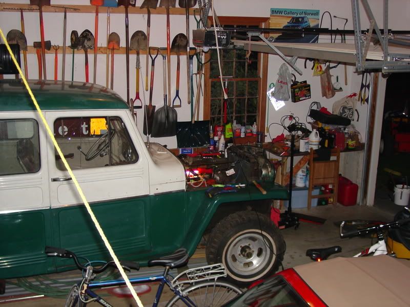

I have been wrenching on the willys a lot.
Got the motor resealed and all painted
Rebuilt the transmission and transfercase.
Repacked the Cleveland joints.
Welded in a new exhaust on the drivers side
Remounted the rad and welded new brackets
Hooked it all back up and Bam it fired up!
Still need to set up a throttle pedal and build a battery box but this is a huge mile stone! I don't have to pull the motor out again I am very happy!! With the chevy conversion you have to install the trans and then the motor and lining up the input shaft IS a B@tch.
