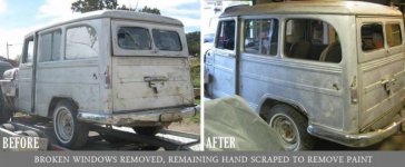

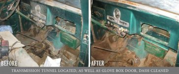

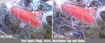

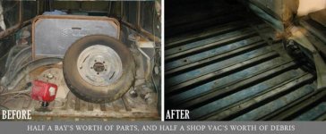

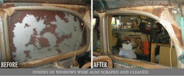

The 1955 Willys Wagon I own was rescued in Western Colorado two years ago. The owner was a coworker of my dad's and about to take it to the scrap yard. My dad didn't like this idea, so I went with my dad and took pictures while they loaded it up to become his project. On the way home, my dad decided he didn't really want to restore it and if I covered the travel costs, it would be my project. In the next two years, I cleaned it up, found some parts, tried to restore the (not original) engine, rebuilt the carburetor, new hoses and spark plugs, got it inspected and appraised to own a restoration title since there wasn't one from the owner, etc. Unfortunately, my knowledge base has come to an end, as has my dad's interest in helping on it, and the end of the month it has to be moved. I've listed it on Craigslist, but no bites yet and since I haven't quite let go of my need to restore and drive it myself, I called a nearby shop that might handle things like a new engine and rewiring, etc. and they figured about 100 hours at $84/hr plus parts to get a new working engine, etc. It has new wheels and roller tires (though one may be mildly bent since one deflates) and the engine only attempted to start once, and further investigation found the pistons don't spin easily, so he thinks it just needs a new engine. (It's kinda too big for the compartment anyway.) Ideas? I have access to a manual engine hoist. But I haven't the knowledge base on what to do now or if it's just in too bad of a shape to even bother and I should slash the price and let it go. (Instagram hashtag is #grampajeep as I own a Liberty and always called it #babyjeep. I know a Willys is different, but it's what I went with.)

That's really a great story you've captured so far Anastatia. Cleaned up well. Thanks for sharing your photos. This is an extremely helpful forum. Great know how and experience and if you require parts etc always ask on the forum as the members offer some great deals.

By the look of the shift levers the ford I6 has been adapted to the stock T-90 & D-18. Nothing wrong with that.

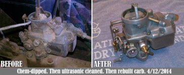

I'd start with trying to get the engine to run before seeking another engine. The carb I saw in the pix will need to be rebuilt after a good soaking. These are super easy carbs to rebuild. Then with clean gas (I'd use a lawn mower tank hung from the hood). Charged battery, you should be able to see what you're dealing with.

The Willys is locked in a business garage off of Wolfensberger Rd in Castle Rock that is downsizing to fewer offices and as such this single indoor garage space will no longer be under the lease. (Hence the quick need to move it that's complicating things.) I've soaked and rebuilt the carburetor, so we're good there. And we attempted to charge the battery, etc. and since it didn't seem to work, I hear going 12V is the way to go anyway in case I have trouble somewhere that I can get a jump from a traditional vehicle.
